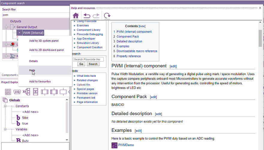

If you are not sure what pack to get to be able to use a component then all you need to do is find the component within Flowcode, e.g. using search, then select help for the component.
The required pack will be shown:
Required component pack.png (193.42 KiB) Viewed 2538 times
Timers are used but you don't need to worry about any other pack apart from the one listed.

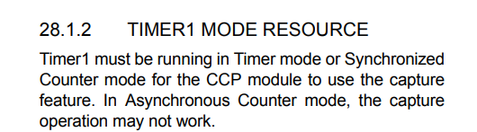

No I wasn't worried about getting the right pack. I ordered the basic i/o, that has the PWM functionality.
But I was wondering if that PWM_fade routine used any of the timers of the PIC16F15355.
As you recall, there were some issues with timer - and IOC interrupts in my project, which were resolved thanks to you.
This PWM application is part of the same project and I just don't want to get into the same situation, hence my question if it uses a timer resource.
I thought that CCP (which is used for PWM) required a counter.
Edit: I think I answered my own question:
