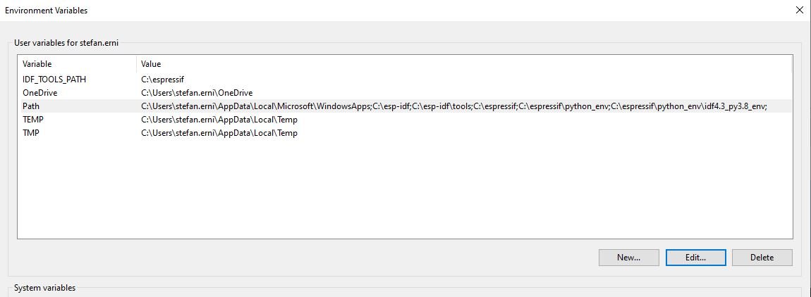

I know where to look but I haven't changed it yet. I'm only on the second computer on Monday, now I'm on the first computer that works fine. But I'll check on Monday whether and how the path is set for the Phython.
Printscreen from the working computer

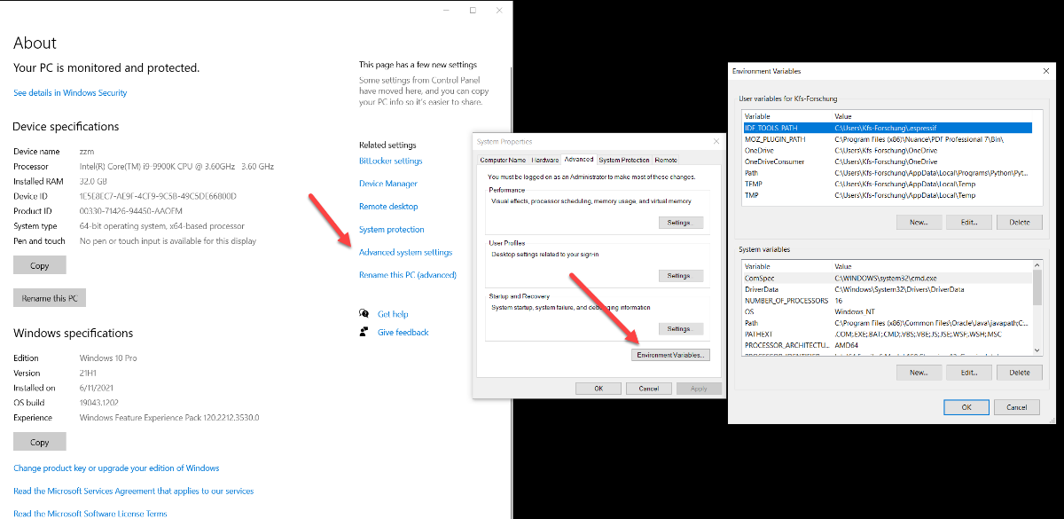

Re: ESP32 Compiling error
Posted: Mon Sep 20, 2021 8:29 am
by stefan.erni
Hi Leigh
I'm on the second computer.
You are right, the entry is missing. But the folder is also missing (user\kfs-forschung\AppData\Locals\programs\Phyton37
I tried to add some path (folder) but it never found this Python.

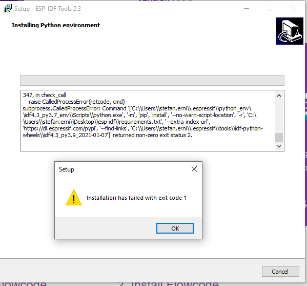

Posted: Mon Sep 20, 2021 10:57 am
by stefan.erni
Hi Leigh
I did, but I get a error.

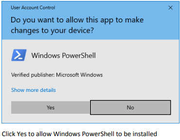

Posted: Mon Sep 20, 2021 12:57 pm
by medelec35
I wonder if it has something to do with:
I thought there is a prompt to give admin rights?
Posted: Mon Sep 20, 2021 3:30 pm
by stefan.erni
Hi Martin
Yes you are rigth, there is a problem with the powershell.
There was no promp and on the end no powershell.
On this computer I have admin rigthts but in way limited and is behind a big big firewall.
I have to think about what to do.
