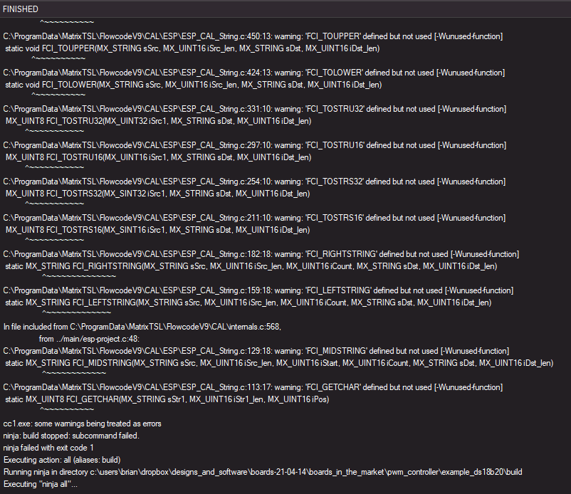

I ordered some probes from china and the ended up being DS18B20, I found the example on wiki but for some reason it will not compile to the esp32, Keep getting warnings and then it fails Could this be something I'm doing or a problem with the 1 wire component?

Your UART is set to Software mode, this isn't supported on ESP, could you use a hardware channel?

Thanks that worked now to figure out why I'm getting a loads of 0000 probably not connected to the right pin on the esp32 module Is the pin 10 (esp module) Port A25 the correct pin for this?
