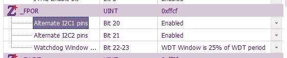

The next snag I've encountered is hopefully obvious to someone more experienced than me. I am looking at a single port pin A:7 that has a switch on the outside, when this switch is on I want to switch a pin on the dsPIC high but I can't seem to make it work, not sure what I'm doing wrong but suspect it has something to do with variables and return values.

Your project looks ok to me though you might need to look at your configuration settings, the watchdog timer is enabled which could be causing problems.

I beleive it could be these configuration settings at fault, they probably should be set to disabled to match your I2C pin selection.

Hi Ben,
Yes that was the issue, I am now reading port pins without issue.
