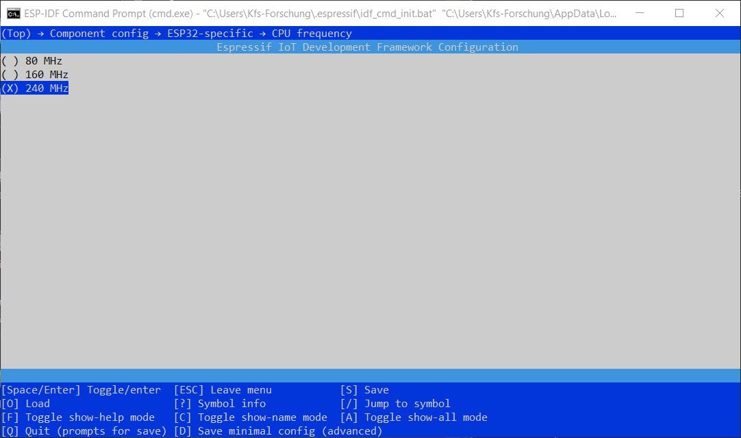

For the ESP32 it's in the config file but Flowcode has no option for 80MHz.
Info about it:

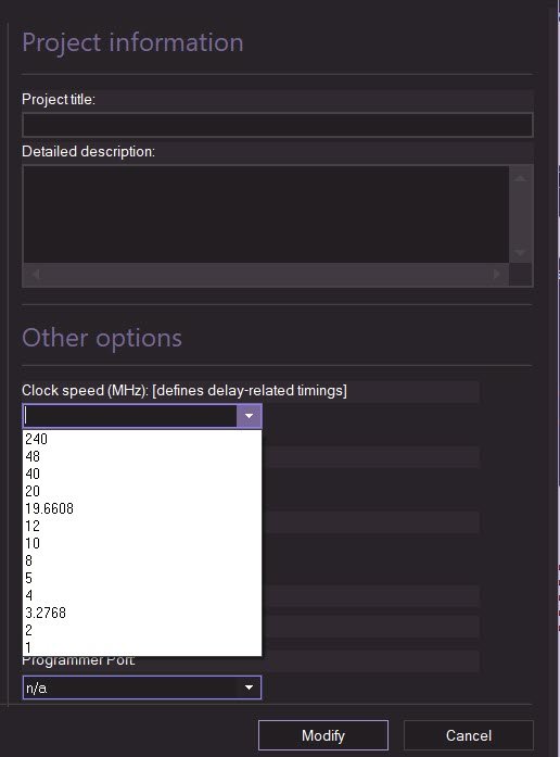

It's a combo box, you can type in your own speed
Re: ESP32 How to run on 80MHz instead of 240Mhz
Posted: Tue Apr 19, 2022 9:14 am
by stefan.erni
Hi Leigh
Thanks a lot for the info.
I had to enter 80 few times and then it worked.
