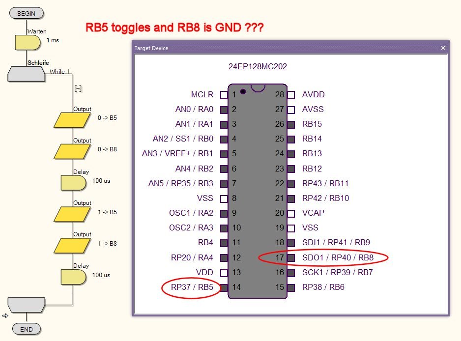

Here are now some more hints while RB8 is not working:
a.) changing the cpu --> same error
b.) switch off all other moduls --> same error
c.) writing in a while loop 1 and 0 with delay shows, that on RB8-RB11 is no signal coming out. Other RB-Pins are working.
Is here a bug in the cpu-component?
Jorg

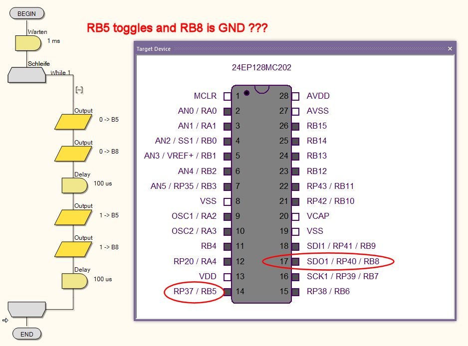

Posted: Fri Oct 15, 2021 3:26 pm
by Jorg_Guldner
Hello Ben,
I downloaded the component files and tries again. B8 is no signal coming out? B5 is working!
The other pins described a post before are not working, too.
Please have a look to the attached picture. It`s only a simple program.
Any ideas?
Re: GLCD SSD1327 SPI needed
Posted: Mon Oct 18, 2021 10:01 am
by BenR
I've been looking into this one for you and I can't seem to replicate the issue on 16-bit EP hardware. I've also looked through the datasheet and there shouldn't be anything specific on the upper PortB pins that is causing a problem.
To rule out some form of CAL issue can you try this with a C icon and see what happens, all the PortB pins should toggle on and off together.
