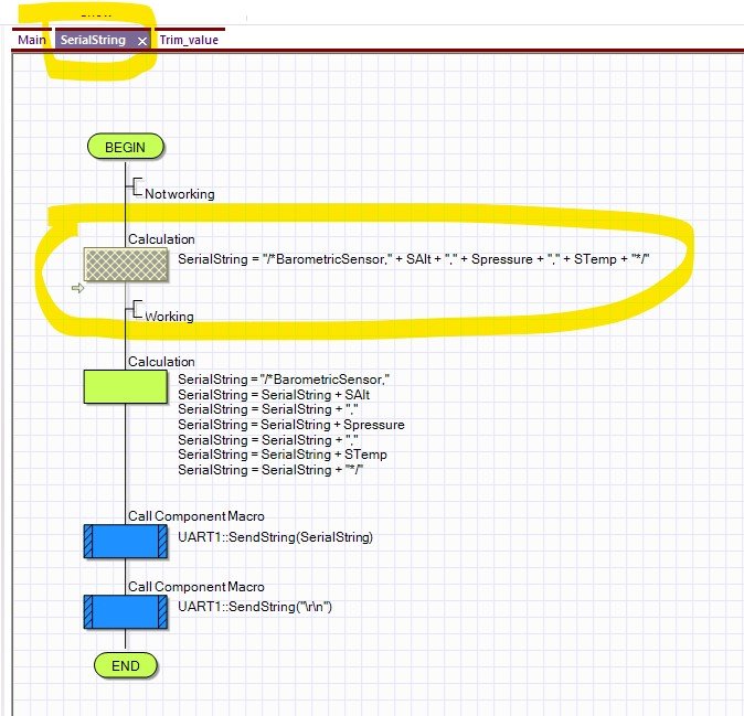

I saw a strange problem when make a string calculation before to send the string to UART.
That calculation result is wrong even if in simulation the result is good.
SerialString = "/*Sensor," + SAlt + "," + Spressure + "," + STemp + "*/"

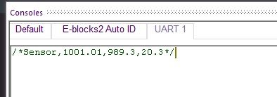

simulation result
string from UART console in debug mode.jpg (10.2 KiB) Viewed 11395 times

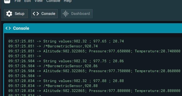

But When send the String SerialString to device from UART, there is always only 22 characters sent
I did different test with different begining of the String to see how it affect the calculation as you can see there is always 22 characters
/*BarometricSensor,9*/ is 22 characters
/*Sensor,982.88,977.*/ is 22 characters
/*B,976.7,1009.58,20*/ is 22 characters
as you can see, the 2 end characters "*/" are present but the middle is missing
Then I did a test without the 2 last characters
result is 25 characters : /*Sensor,983.73,977.20.93
then Changed the beginning of the string "sensor" by "BarometricSensor" to increase the string length
result is 25 characters : /*BarometricSensor,920.74
The string is always incomplete and If the string is without "*/" at the end, the length is 25 if with "*/" the length is 22 characters
I did a test with a different way of the string calculation
SerialString = SerialString + SAlt
SerialString = SerialString + ","
SerialString = SerialString + Spressure
SerialString = SerialString + STemp
SerialString = SerialString + "*/"
With this way, the string is complete: /*Sensor,984.57,977.68,20.83*/
Even is the beginning of the string is longer
10:08:57.205 -> /*BarometricSensor,982.32,977.74,20.84*/
Could you check what is the problem please . May be there is a link with TMP String Size.

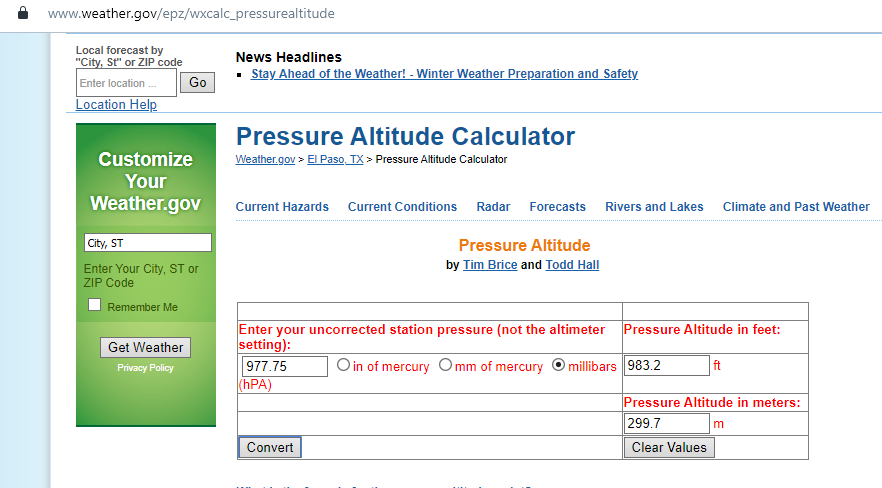

The altitude (in feet) is not that much different from this website calculator:
The Altitude is just a calculation purely based on the pressure reading.
As the pressure changes, it won't show a true fixed height above sea level.
Note, the Average sea-level pressure is 1013.25 mbar, so at that pressure, the Altitude reading will be around 0.
What I did was if I wanted to measure the difference in altitude, I would tare the altitude to 0 then any pressure change would then be converted to Altitude.

Could it be your terminal software?
I just tried your flowchart with both Tera Term and RealTerm
The results for both when sending via TTGO:
String values:20.21 ; 1012.48 ; 25.49
/*BarometricSensor,20.21,1012.48,25.49*/
Altitude:20.207380; Pressure:1012.480000; Temperature:25.490000
String values:19.93 ; 1012.62 ; 25.36
BarometricSensor,19.93,1012.62,25.36
Altitude:19.934228; Pressure:1012.620000; Temperature:25.360000
All looks complete to me.
Re: ESP32 TTGO+ BMP280 temp sensor BUIL FAILED
Posted: Wed Feb 02, 2022 5:57 pm
by Xbiotec
did you tried with the 1st calculation enabled and the second calculation disabled ?
From my side I also tried with Putty and result is wrong too
