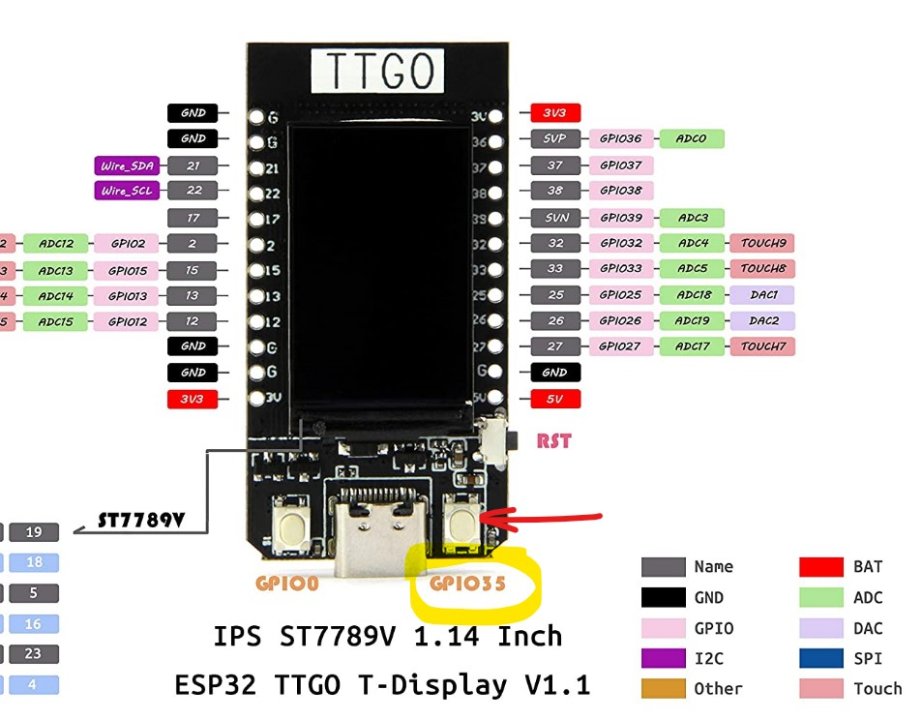

In // , I'm also working on a project with ESP32 TTGO T display.
To be able to read the battery level voltage, I need to enable the IO14 , Thx to add this IO available on the Component
TTGO display Pin IO14.jpg (34.56 KiB) Viewed 16090 times
Re: IO14 on ESP32 TTGO display not available to read voltage
Posted: Tue Nov 09, 2021 4:05 pm
by BenR
Many thanks for letting us know. I've pushed an update to the library update system that should make this pin available for you now.

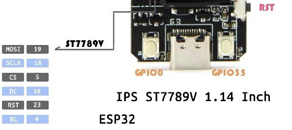

Please add the IO0 and IO35 to be able to use the 2 push buttons.
buttons and Display.jpg (26.38 KiB) Viewed 16065 times

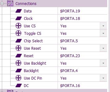

Could you also change the gLCD IO to port A like on the pictures (to be able to start new project with the good GLCD pin setup)
GLCD pin.jpg (23.7 KiB) Viewed 16065 times

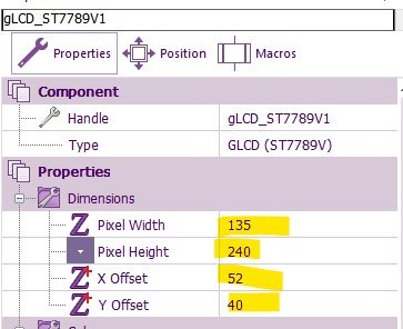

X offset and Y offset are not good and need to add offset like you can see on the picture. Could you check why please.
GLCD size.jpg (23.41 KiB) Viewed 16065 times

Pins 0 and 35 added for you now.
The X and Y offset are just down to how the rows/columns of the display has been wired to the driver IC. Is it working correctly with those settings?
Posted: Mon Nov 22, 2021 5:32 pm
by Xbiotec
Ben thx for added these 2 GPIO.
Yes with these setting work well
