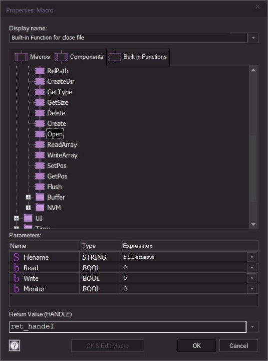

And that there is no command macro for file close so I use file open but with parameter 0 for read and write.
I suppose that's what Ben means.
I will continue to save and open large amounts of data in arrays.
to close the file

stefan.erni wrote:
Wed Sep 21, 2022 12:59 pm
Use the "flush" API call to close the file for reading/writing as in the example.

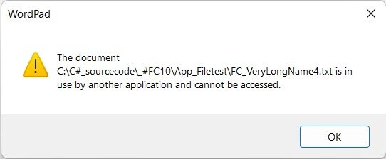

Posted: Wed Sep 21, 2022 2:20 pm
by stefan.erni
Hi Steve
If I use the example with the flush I get this message. So I have to close FC and then I can open the file.
I don't know exactly what I'm doing wrong that it doesn't work for me on my computer.
Re: App Developer build in function File
Posted: Fri Dec 02, 2022 2:47 pm
by stefan.erni
Hi Steve
Now it's working nice to close the file.
As you wrote flush and open with 0,0,0
