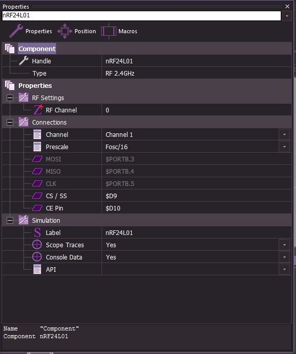

This is my setup right now, it works now, but the code compiler gives me a warning. (I wrote above)

Good you have it working. The FC SPI code always outputs a warning on Arduino (AVR) platforms which can lockup if the pin is set as an input.
You are using pin 10 as chip enable - which is an output - so hopefully no problem. Arduino Uno shields usually use the pin as CS...
