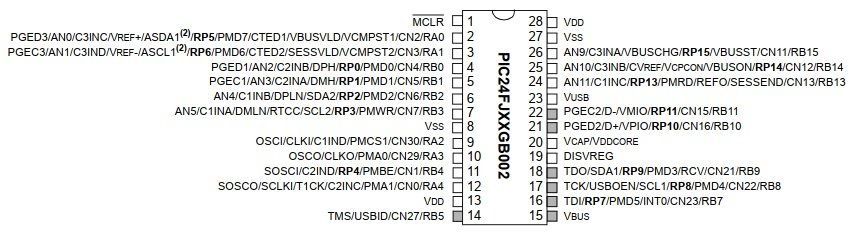

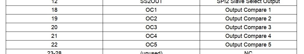

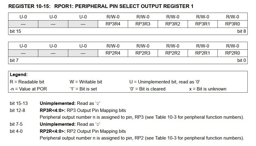

Here are the PWM channels
Here are the output register bits, showing RP2R and RP3R inside register RPOR1.
And finally the RP pin assignment
Hopefully with a simple test we can get to the bottom of what's going wrong for you.

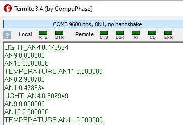

I have the PWM channels working - I don't know why, but they are running. Some of my Analogs are not running. Could you take a quick look and see what I am doing wrong Ben?
The analog readings for AN9, 10 and 11 are reading zero - I have measured them on the pic, and they do have voltages.

Sorry please can you post your .fcfx project file and I will investigate for you.

here it is - Work in progress- Only concerned with AN9,10, and 11 which are not responding. I have applied 1.5 volts to each individual pin and see no numbers. The AN4 is not working but that is to be expected - According to the datasheet, it is not available. I will be trading pins on that one.

Edit, I've found a problem with the ADC definitions for the GB002 / GB004 family and hopefully with the latest updates things should be working correctly for you.
Let me know how you get on.
I didn't see any problems with AN4 while looking through things so hopefully this one will work ok for you now too.
