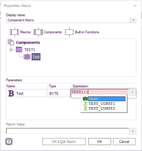

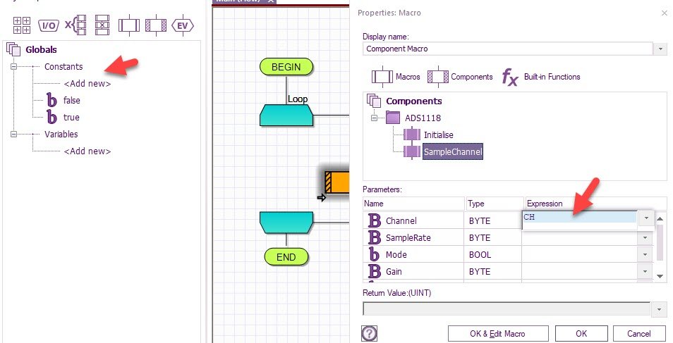

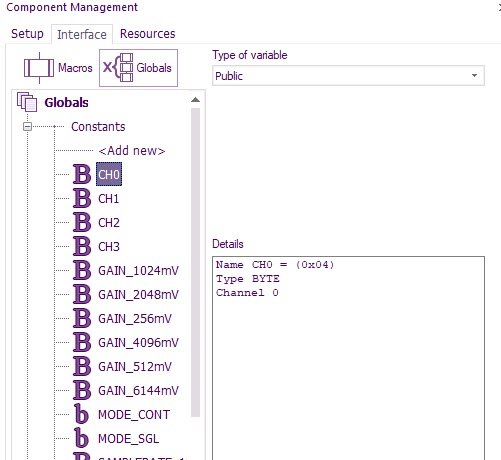

I am trying your method with the setting of Constant to public I am having problem when the component is exported the Constants does not show up anywhere what I doing wrong.( I am trying all advises given here Martin and Steve's options are working) I must be doing something wrong that your option is not working :D
Here I set them as Public and trying to set a name as I know it (example CH0) then flowcode says unknown variable
Appreciate your help Ben! :oops:
Re: Constants Visibility
Posted: Thu Feb 25, 2021 12:01 pm
by BenR

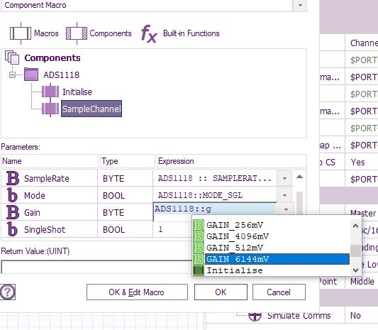

It looks like they only appear if you know to enter the comp name followed by ::. I'm sure it used to be better then this but has maybe become a bit buried by other updates and improvements.
Posted: Thu Feb 25, 2021 12:24 pm
by p.erasmus
Hello Ben.

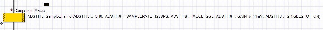

Thank you this is working but as you said could maybe be a bit better ,I do not know this,it only makes a bit difficult for a user to know what to enter and
it makes the call very long in the FC ,Maybe for know Martins and my idea of using the mask as properties look neater what would your advise be ?
I am new in component making cannot judge the correct or more elegant ways :oops:
The call mess the Flowchart a bit :D :D :D

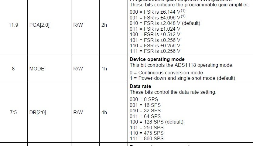

Thinking about maybe using the bit names as per datasheet will shorten things just not sure how a user which does not really understand datasheet will use the component, if he did he probably do not need a component as he can code himself, I have to think a bit on this ;
This device can handle differential/Single ended and temperature elements at different channels at different Sampling speeds so it needs a bit of configuration each time you want to sample a channel which makes it necessary to have the ability to configure the sample you want
