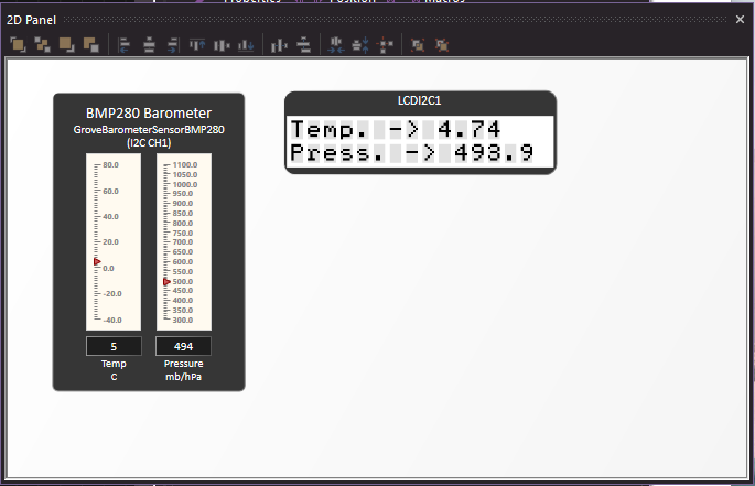

HI. Cannot read BMP280 pressure, what is the problem?
Re: Components not loadable / BMP280 no values
Posted: Sun Mar 02, 2025 11:00 pm
by medelec35
Hello, You have not attached your project file.
We can't help you until you do.
Posted: Mon Mar 03, 2025 6:39 am
by Viktor74
HI I'm sorry, I am adding files, maybe I'm doing something wrong?
Posted: Mon Mar 03, 2025 8:55 am
by medelec35
Thank you for your project file.
Simulation of your project is working for me.
BMP280 Pressure sim.png (38.69 KiB) Viewed 6847 times
I would recommend doing a full component update
Help > Library Updates...
Change Files in-use to Full database.
Then reload your project and try again.
Posted: Mon Mar 03, 2025 12:52 pm
by Viktor74
Hi Martin. I updated the library and now everything works great, thank you very much! ;)
