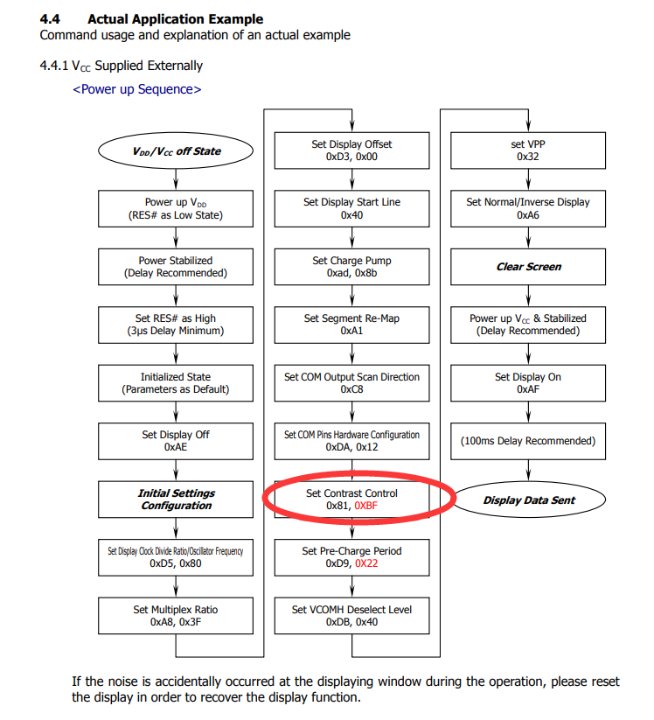

Hi! Martin
I forgot to share the information i got from the manufacture, below for your reference.
https://files.waveshare.com/upload/0/08/SH1106_V2.3.pdf
Thank you.
Abhi

I have spotted that the fonts available was only 4, when it should have been 8, which updated displays show
The Write_Command was exposed to the top level, but Write_Data was not.
I have fix those.
Looking at the datasheet the charge pump was set at the minimum = 6.4V.
This would give the minimum contrast range
Power on the the flowochet you shon has it set to 8V.
Since you want a good contrast rage I has set it to 9V
Abhijit wrote:
Wed Jun 18, 2025 9:32 am
By the way the fonts "Character Spacing" and "Space Width" do not show the drop down menu in this component too.
The way the fonts are now used has automated the process.
There should not be a drop down for them.
If there is then again the display has not been updated.
Can you try again with the attached.
You will know if its the updated version as font count will be increased to 8.
First try toggling between contrast values of 1 an 255
If it does not work can you send the commands 0x81 then the contrast value.

I have found SPI display, and checking it myself as I have got a logic analyser I can check if the data is set correctly.
Re: OLED SH1106_SPI Contrast
Posted: Wed Jun 18, 2025 12:50 pm
by Abhijit
Hi! Martin
The latest file works, no doubt there is some action happening in the display but it is not visible like some other displays where one could make out the difference, i checked two values 1 and 251, at 1 the display do not get completely dim but no doubt the intensity of the LED's get less, and at 251 pretty bright.
To get sure i checked the current consumption of the entire ckt at 1 and 251 values, and for my surprise there is a difference of 5.5mA so i think your contras property is working well.
I hope you too will get correct readings from analyzer.
Thank you again for your time.
Abhi
Posted: Wed Jun 18, 2025 1:48 pm
by medelec35
I have found the same results as you.
There is dimming, but its not as much as I assumed it could be.
I have changed the simulation to roughly match what the hardware does and you can use any value 0 to 255.
I have also attached a simple demo I used.
