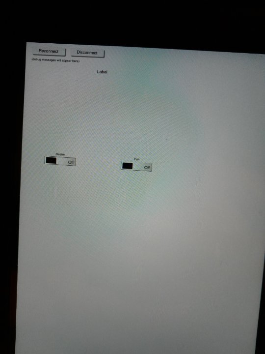

I'd forgotten just how unfriendly and troublesome these can be and it is little wonder it has been in a drawer for so long. Eventually got both the above files downloaded on the stupid machine but could I find them? Of course not..... that would be a useful feature....
Ages later with the help of a file manager I had downloaded years ago I located them and there was a safari icon associated with them.
They both opened up but the gauges and graph did not appear, just buttons (functional). I have no idea if it does screenshots or not but I attached a photo of the screen.
I tried to download different browsers but app store tells me pretty much everything in the entire universe won't run on this. Even Classilla threw a wobbly but did tell me to try later....
As per an above post, I would need to plug the useless crapple device into a Mac to run web developer etc and whom in their right mind thought that would be a great idea?
If you are running a more modern OS than 9.3.6 then you could try downloading Firefox, Chrome or any of the alternatives to Safari that are out there to see if they work. That is about the best I can guess at present.
