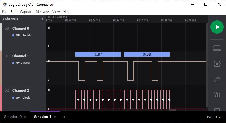

The CS pin for me is working fine with the API CS Pin property of the cal_spi1 component set to 10 to generate the CS signal on pin 10.
The MOSI problem appears to be something to do with complications surrounding drawing the traces on the data recorder window. If you set the Scope Traces property to no then the MOSI signal works correctly and the SPI packets are sent together correctly in a single transaction.
I'm investigating now why the MOSI data is not there when Scope Traces is set to Yes.

Right I've found a bug in the SPI code on the Arduino firmware and this has now been fixed with the latest file here.
https://www.flowcode.co.uk/wiki/index.p ... _component
Here is your project file with Scope Traces set to no, this will work with either the current firmware or the new firmware. If you set Scope Traces to yes then this will only work with the new firmware.
AD9833_Scada.fcfx
(20.83 KiB) Downloaded 663 times
Hopefully this fixes the SPI problem. did you say you're having a problem with I2C too?

Thank you for your efforts the SPI is working again as it was working with the old injector,

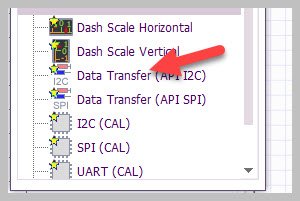

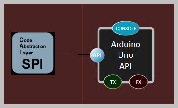

In the past we used the SPI or I2C cal component then the injector and the UNO_Scada
now we have the cal component or the SPI/I2C Mater component connecting directly to the UNO:_Scada I am lost as wat is the function of the DataTransfer Components ??
