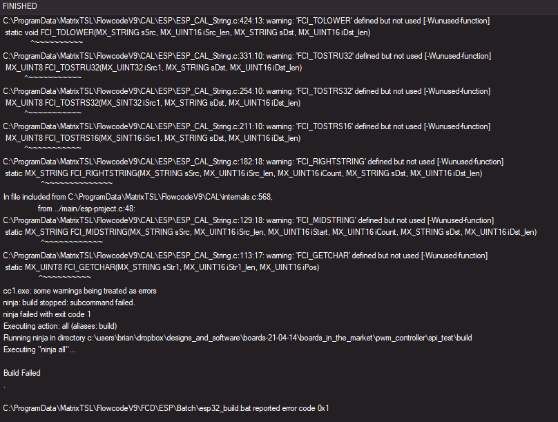

I got time to test the system and there seems to be a problem now that I have updated the components the program wont compile I have not changed anything other then update the components and I get the following error message.
error message.png (72.14 KiB) Viewed 9540 times

by LeighM
Please could you attach the project msg.txt file?
That will help much better than a partial screen shot

Hi Leigh
Here is the Compiler message
Compiler Message.txt
(61.93 KiB) Downloaded 833 times

by LeighM
Thanks.
Looks like there is an issue in DSPOutput::GetFloat()
I'll leave it for Ben to look at :)

by Steve-Matrix
The error location has changed for some reason. Your original one was:
../main/esp-project.c: In function 'FCD_0e811_DSPOutput1__GetFloat':
../main/esp-project.c:975:29: error: implicit declaration of function 'DSPBuff_0_Get'; did you mean 'DSPBuff_2_Get'? [-Werror=implicit-function-declaration]
 #define DSPOutput1_Ref1_Get DSPBuff_0_Get
...but now it is this:
../main/esp-project.c: In function 'FCD_0db01_DSPPIDControl1__Process':
../main/esp-project.c:942:33: error: implicit declaration of function 'DSPBuff_0_Get'; did you mean 'DSPBuff_2_Get'? [-Werror=implicit-function-declaration]
 #define DSPPIDControl1_Ref1_Get DSPBuff_0_Get
It looks to be the same error, but is now in another part of the code. Did something change in your project to cause this?
