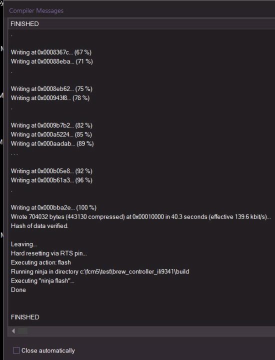

Hi Guys
Can someone please explain why my program will not compile with the ili9341. The first message i get is as follows
error 1.txt
(63.36 KiB) Downloaded 803 times
If i try to compile a second time then i get this message
error 2.txt
(63.36 KiB) Downloaded 883 times
Brew_controller_ili9341.fcfx
(149.06 KiB) Downloaded 876 times
Re: ESP32 Compiling error
Posted: Wed May 04, 2022 8:31 am
by stefan.erni
Hi Jollybv
I can compile it....
Posted: Wed May 04, 2022 5:41 pm
by LeighM
Builds for me too.
I notice this in the error2.txt ...
CMake Warning in ../../bootloader_support/CMakeLists.txt:
The object file directory
C:/Users/brian/Dropbox/Designs_and_software/Boards-21-04-14/Boards_In_the_market/PWM_Controller/Test_gLCD_ili9341/Brew_controller_ili9341/build/bootloader/esp-idf/bootloader_support/CMakeFiles/__idf_bootloader_support.dir/
has 222 characters. The maximum full path to an object file is 250
characters (see CMAKE_OBJECT_PATH_MAX). Object file
src/bootloader_common_loader.c.obj
cannot be safely placed under this directory. The build may not work
correctly.
I suggest that you copy your project to a shorter path and try again.
Posted: Thu May 05, 2022 6:56 am
by jollybv
Hi Leigh
Thanks for that it has solved the problem and I have learnt something new, maybe that is why I have had to save my projects 2 or 3 times before it will compile (path to long)
