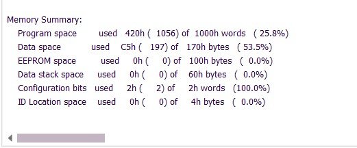

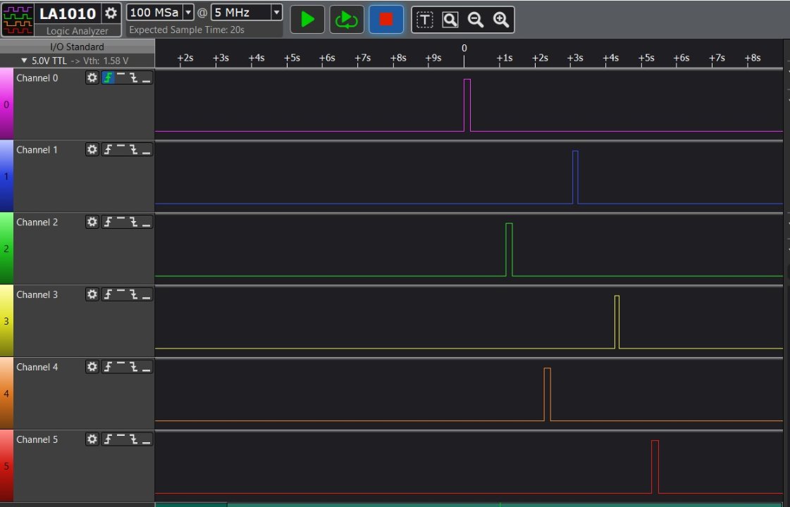

Having done some tests, what you want to do won't run on a 88' if using DSP as it does not have enough RAM. You could use a 1847 and I have attached an example. Well I hope I've attached the correct one <s>
You need to use an 8MHz Oscillator and I used the internal one, and then set appropriate timer delays etc. I don't have a 1847 but the code fits inside. I ported to a different PIC for testing with these results:-

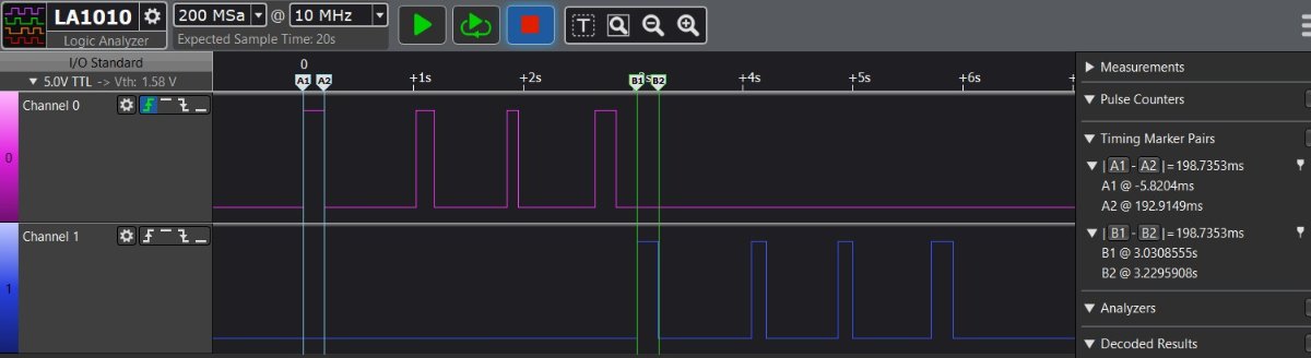

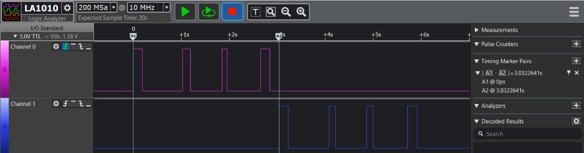

In the screenshots below, Ch0 is input-1 with Ch1 output-1. You can see the delay between input and output in the train of pulses
Screenshot 2026-01-31 143056.jpg (46.11 KiB) Viewed 4604 times
This shows output accurately reflecting input.

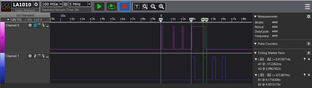

This last shot shows all three inputs (0/1, 2/3, 4/5)
