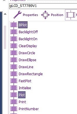

what is the difference between BPlot and Plot ?
Capture d’écran 2022-02-09 080927.jpg (21.11 KiB) Viewed 5447 times

The B represents Background.
Plot will plot a pixel with the current foreground colour setting.
BPlot will plot a pixel with the current background colour setting.

I should also mention there is a tooltip shown if you hover over the component function.
If you feel the wording does not make the functions clear enough, then we can look into getting the wording amended.
