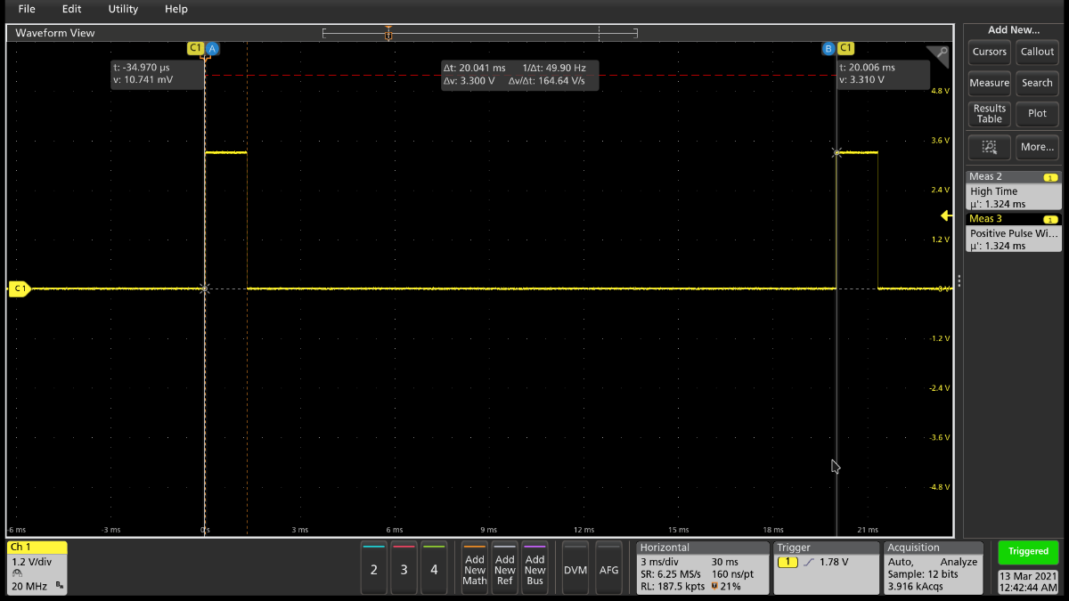

Scope shot below:
Additional question!! Is there a way to edit the frame rate. Now it is fixed at 20ms (50Hz). Cool would be 15ms and 10ms (75Hz and 100Hz) too.
BR
Dirk

Hi Dirk,
Brilliant glad it's working for you the servo controller component is currently fixed to 50hz but the pwm component should allow you to easily do this.
