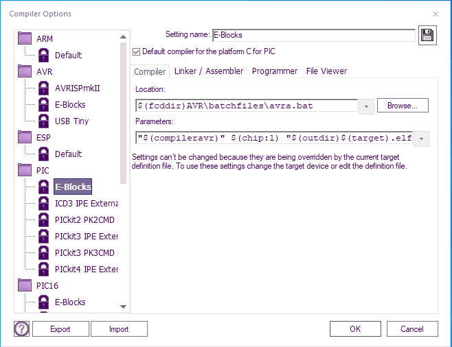

What you need to do is Select Build, Compiler Options
Select E-Blocks just under the PIC section, then make sure Default compiler for the platform C for PIC is selected.
Compiler Options.png (40.68 KiB) Viewed 3151 times
