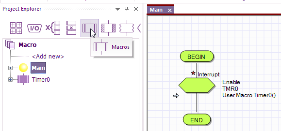

Until a fix is released, there is no need to shut FC down.
The new macro will always appear in View, Project Explorer, Macros
Interrupt Macros.png (22.55 KiB) Viewed 7569 times
