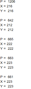

Thanks that worked for the resetting. Now if I touch the screen it reads the touch once then the T-IRQ pin stays high and wont toggle when i touch the screen. If I remove the T-CLK then rest the ESP32 by removing then restoring power the T-IRQ line toggles but obviously I cannot read the coordinates without a clock. It seams to me that every time the XPT2046 reads it stops the T-IRQ for some reason. Also the X & Y coordinates are always the same and I assume that is wrong because the display is 240 x 320.
This is the results i get when I trigger the interrupt manually while touching the screen, it only seems to be reading one access. As I have the screen turned 270 degrees it looks like the x access is the missing one.

The x y problem is solved, In the test program I noticed that I was sending the x value to the y when printing to the UART
I will try work around the interrupt problem for now.
