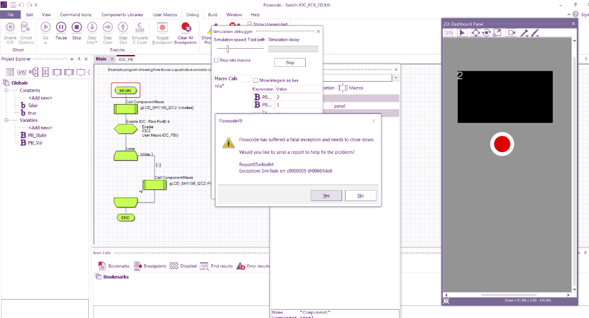

I have tested with 2D panel and also with 3d panel, the same working code from previous post above.
And I got a a fatal error in 2D simulation, Flowcode shuts down.
In reality the code works, also the one with 2D panel.

I'm afraid you cannot enable the same interrupt twice pointing to two different macros, even selecting different pins the second macro will never get called.

I beleive the fatal error was due to two interrupt macros bening assigned to the same interrupt. As soon as I removed this it went away. Maybe something we need to check for in the app.

The 2D panel code works fine in simulation, if there is not breakpoint and if I am not too fast by clicking the pushbutton or too fast after simulation just starts.
But if I am too fast or if I assign a breakpoint in the interrupt subroutine at the PB_Val calculation, then Flowcode goes into fatal error and it shuts down.

There shouldn't be a need to disable and re-enable the interrupt inside the IOC macro, can you try disabling these icons and see if that makes a difference. Maybe that is somehow causing the sim to have a problem. Certainly something for us to look into.
I would also recommend changing the switch debounce property from 1ms to 0 as this could be creating problems when reading inside the interrupt.
