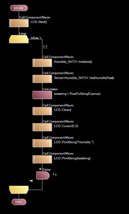

Well I suppose I have missed something from my test flowchart that is preventing the SHT31 sensor component displaying correctly under simulation. I thought being a true 12C component this would be easy to get functioning but the simulation is showing all zeros. Can someone pls put me right. I am reading the humidity into a float, doing a float to string and then trying to print the string on the LCD. I have initialised the sensor and ensured that it is the correct default address and I'm using the C3, C4 I2C lines from the PIC for the data and the clock. Tried changing the baud rate but makes no difference.

Try with a delay so the screen doesn't clear very fast
Add delay:

Two more improvements. Put the init sensor before the while loop and use integer instead of float
mod version:

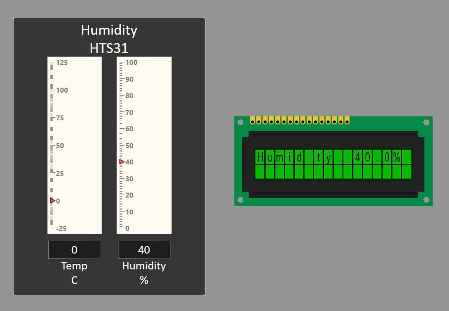

This is how I would use the sensor with FC8 and FC9

Thanks for the assistance. I confirm the flowcode is putting out values on the LCD but can you please confirm from my attached screen shots if your system is giving the same values on the LCD relative to what is shown on the SHT31 component? The LCD output and values of the SHT31 are offset i.e they don't match on my system. To be specific the LCD is displaying correctly the value held in the float variable 'sense'. Somehow the value of the data coming from the sensor and being read into the variable 'sense' doesn't reflect what is being shown on the SHT31 component. Have also tried the flowcode on a PIC18 device and getting same results. Shouldn't the LCD match the values shown on the sensor? Perhaps the I2C and/or SHT31 have been updated and my system has missed the update? Would be grateful if you could confirm what you're getting on your simulated display.
Thanks in advance

Martins FC9 program is working nice on my computer

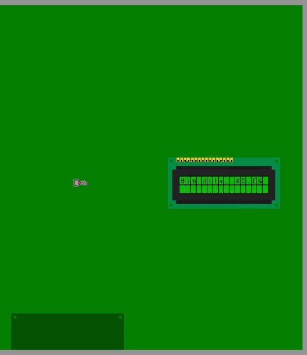

Working FC9 Programm:
But the another program (from you) has no display and an another SMT31 component.

and Martins FC8 program on FC9 is working but green.....

The simulation model is a few % out, but the hardware should work accurately.

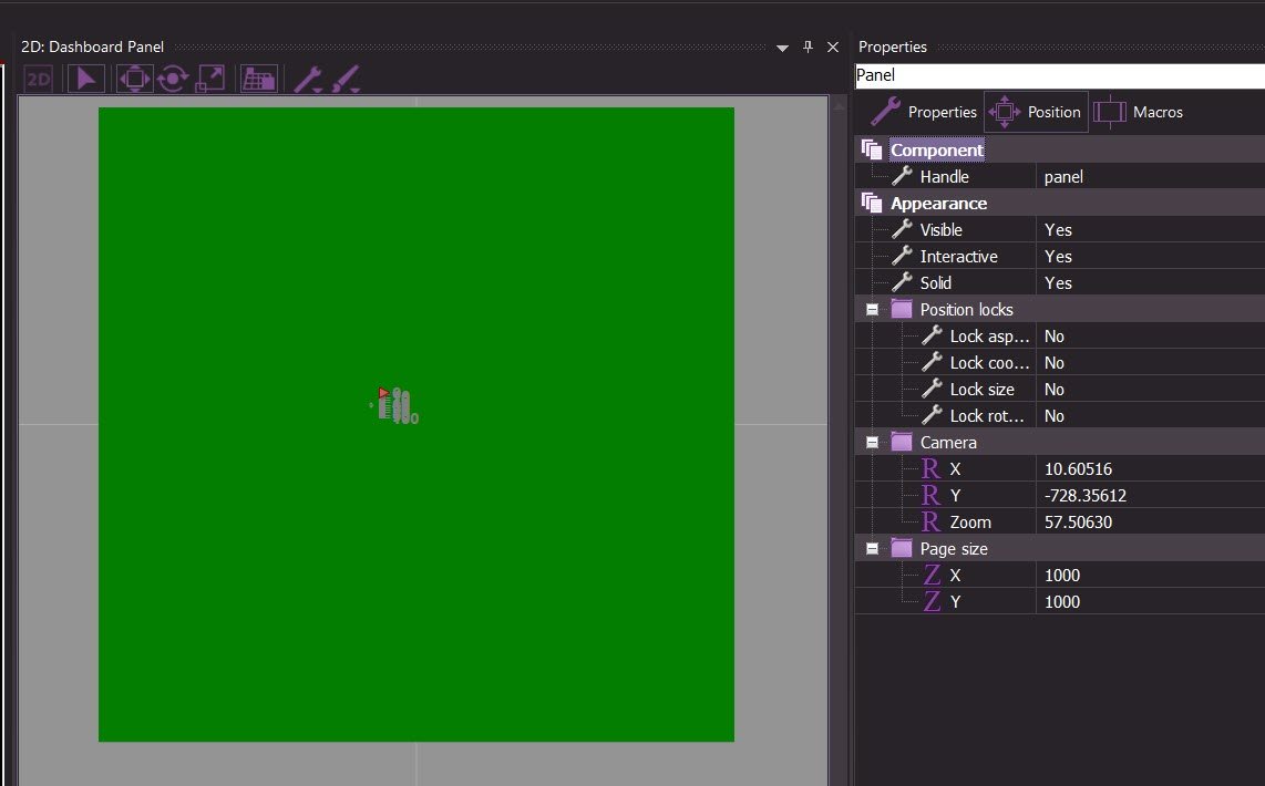

If using the FC8 project on FC9 then you will need to resize the sensor, but the simulation and hardware % should be correct.
