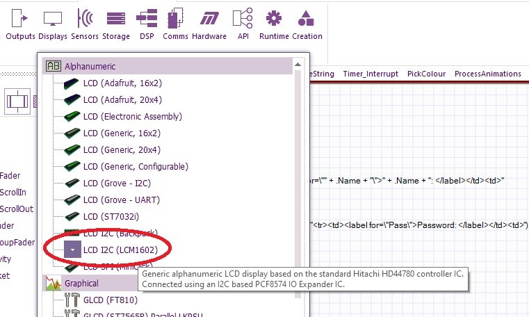

Hello, is it available to make soft for connecting HD44780 display to MCU via I2C using PCF8574T board?
Re: I2C + HD44780
Posted: Thu Aug 18, 2022 10:25 am
by BenR
I beleive we support this already.
Re: I2C + HD44780
Posted: Thu Aug 18, 2022 12:03 pm
by medelec35
There is also the LCD Backpack.
I use that a lot with displays that have a PCF8574 io expander board on the back.
There is a demo file on the wiki.

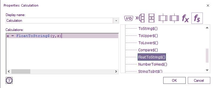

By the way, there is no command PrintFloat variable. In usual connection there is for HD44780. But in combination with I2C I can not print float variable on the LCD screen. Can any resolve this or may I open special topic for this question?
Re: I2C + HD44780
Posted: Sat Aug 20, 2022 3:20 pm
by chipfryer27
You could use the FloatToString$ in a calculation then print the result. I think Ben and Medelec have posted much on this subject so a quick search might be of help.
Below x= the resulting String / y = floating point variable / z = how many decimal points to include
Hope this helps
