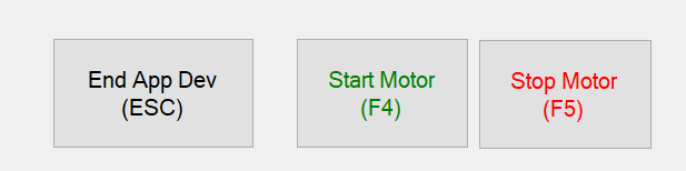

It's working very nice with the App developer and the keyboard button.
Is it possible to add more button components for the App developer like the switch component, but just as a press Button pressed by the mouse?
The text and color should be able to be changed while running.
Show/hide should be able to be changed while running.
And a button can press an another button, if I press End App Dev it's press Stop Motor.
ESC 2021-01-22_17-57-40.png (8.89 KiB) Viewed 15024 times

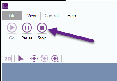

At the moment if I stop the App developer with this Stop Button, the App end right away. Its is not really good when I do a Tesla control

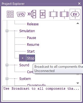

If you need to gracefully do something like flush and close comms then this is possible by enabling the Simulation Stop Event and assigning a new macro to it. This macro should then run and allow you to do any last second things before the app stops.

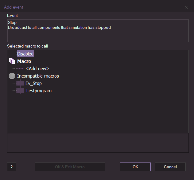

Yes that a what I'm looking for.
I did it but it's give a problem with incompatible macro.

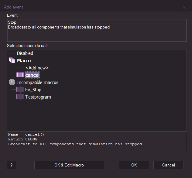

There was just a problem with the return variable missing. Now it's working perfect.
If I press the stop debug it's send lastly a stop at the machine.

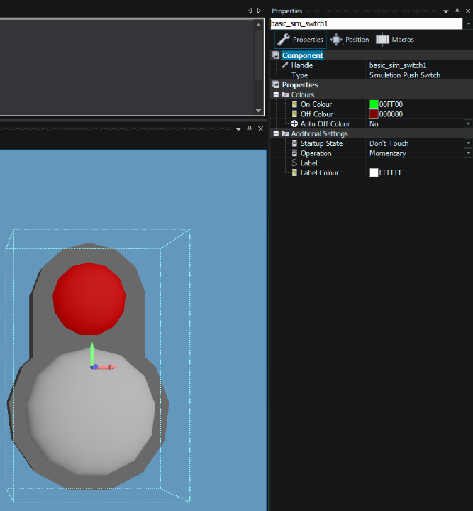

The missing switches should be there now, though still hidden they should now be available via search.
Also not sure if this is of interest but I made a quick demo for making your own switch with images on here.
