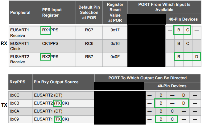

For the UART component, you can only select ports that are designed to be available by the manufacturer.
From the datasheet (I have blanked the 28-pin ports), here are the available ports for channel1 and channel2.
Remap Pins UART Component.png (75.8 KiB) Viewed 3825 times
As you can see, only B and C are avaiable for Channel2
If you want to use port C for both channels, then instead of using channel2 you could use the UART software (Timer) component.

In FC9, Channel1 has only B and D Port options. Occasionally, I see Port C. But when I compile, I get an error. C Port cannot be selected.

If you only can only see port B and D with channel1 then select a random pin.
It should then change from port D to Port C so you can then select the correct port C pin.
