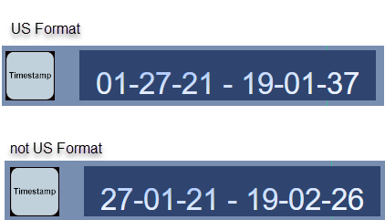

There are only two small problems. After the year there is a space and yy-mm-dd_hh-mm-ss would be easier because the filenames are then always correctly sorted in the folder by year, month, day
01-27-21 _19-17-35.csv //this is now
21-01-27_19-17-35.csv //wish
Re: App Developer Timestamp and EventTrigger components
Posted: Wed Jan 27, 2021 9:49 pm
by BenR
Thanks for letting me know.
I've now added an option for the date to be output as you've specified. As for the space between the date and the time, check your setting for the TimeStamp separator and make sure there are no spaces there. Hopefully that should solve the problems.

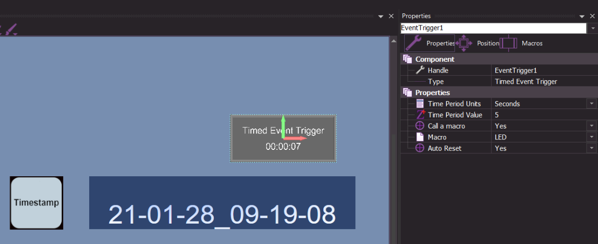

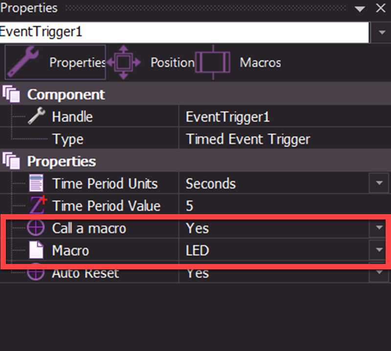

I've also now reworked the EventTrigger component to make it a lot more useful as per your suggestions. I've done a bit of testing and so far it seems to work well.
EventTriggerDemo.fcfx
(10.13 KiB) Downloaded 706 times
Let me know how you get on.
Posted: Thu Jan 28, 2021 8:59 am
by stefan.erni
That is very, very good what you did.
Selecting the macro in propertis is very practical.
The countdown in the icon is very pleasant.
And the timestamp is perfect.
