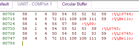

The consoles are proving very useful within App Dev, I have UART and Circ Buffer console tabs.
Is it currently possilbe to have a user defined console, much like I can place a breakpoint for bedugging.
So I could insert a 'Console' request at a given point in the FC and during simulation all data that flows through that point is displayed in console format?

Interesting, I think I have miss interpreted the consoles or at least I only use them in a very limited way.
typically I get a stream of raw data in my console view.
UART Console
UART Console
My assumption was that this console feature was a sampling of the raw data stream passing in/out of a component and was hoping I could achieve the same sort of thing by having an effectivly empty component but that still allows sampling/viewing of the raw data but at a user perscribed point in the flowcode.
All sounds quite different to what you are both describing, to my ears at least. :)
