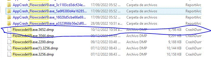

FC9 crash dump file generated.gif (39.82 KiB) Viewed 5924 times
FC9 crash 2.gif (198.1 KiB) Viewed 5924 times
Hi Steve,
I have followed your instructions and I have the next file (only picture attached).
Now, how I could send you the dump file?
Best regards,
KikeRico

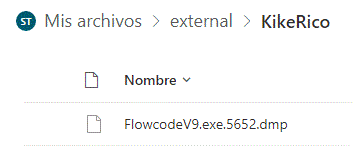

Thnaks and I have uploaded the dump file at PM that you send me.

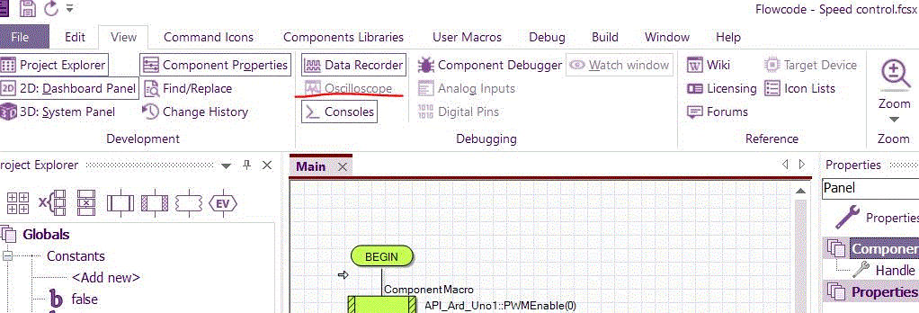

If I'm not wrong in App Developer isn't active the Oscilloscope tool :?:
FC9 App developer osc.gif (65.89 KiB) Viewed 5860 times
Well, I have open Data recorder and Console, the crash still occurred :| I also trying, restoring default values in Global Settings only to test but with the same result.
Going further I have started a New Project - App Developer from scratch and the crash it happens again.
Also for testing, I have installed FC9 on another Laptop with Win10 and the behavior are the same, so I discard the laptop configuration as root cause of crash bug.

KikeRico wrote:
Mon Dec 12, 2022 5:42 pm
Ahh - that explains it and I now see why the crash is occurring. I missed that you were creating an App Developer project.
The crash occurs because Flowcode is trying to set the default position for the Oscilloscope window, but that is not available.
Thanks very much for helping identify this issue.
