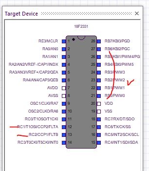

I have a doubt related to PWM of the PIC18F2331 family. They have 6 or 8 channels in hardware, but FC9 only permit 2 channels.
Please you could consider to include more channels for this PIC family. It should be very useful for ACIM control technics & algorithms, we need to use 6 PWM channels at minimum for control the motors.
Thanks a lot.

The FC PWM Component supports the Standard CCP module(PWM) of the chip this particular chip has only two CCP modules the reason you can only select 2 PWM signals.
The 2331 chip has a specific module for Driving PMSM Motors (Brushless or Induction for example) which is called the MCPWM module which contains on this chip PWM0 - PWM5 this module allows you to run various Motorcontrol of Switch mode Power Supply circuitry ,however due to its many available configurations makes it hard to make a component that can serve all the different configurations,Matrix has in the past indicated that they will not do this ,however may be they will be willing now. We have been using a C code icon and with the help of the Datasheet configure the MCPWM module in FC for our needs.
As you will see below to the left is the 2 channel CCP module and on the Right the 6 channel MCPWM module

It is simple to integrate a few lines of C code within Flowcode to control the more advanced and esoteric functions of the more complicated microcontrollers.
Some of these modules have many features and it is difficult to cover all possibilities with a component.

p.erasmus thanks a lot for the CCP module explanation, now is clear for me why many of micro-controllers (PICs) have one or two PWM channels only. For PIC more specific hardware, like MCPWM in PIC18F2331, I need to deal with C code to explode all characteristics as mention by Steve-Matrix.
My interest in MCPWM module is to use in AICM control. I'll try to do with C code :D
