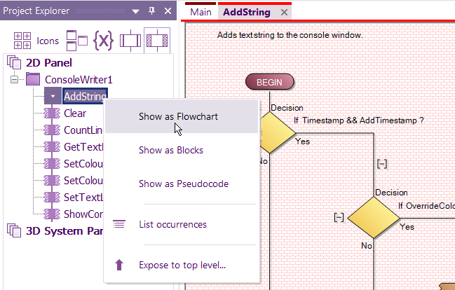

In addition, users with the Professional pack will have access to 2 additional features:
1) View code for components directly in their projects (by right-clicking on macros in the "Components" tab of Project Explorer)
show component code.png (46.98 KiB) Viewed 4159 times
