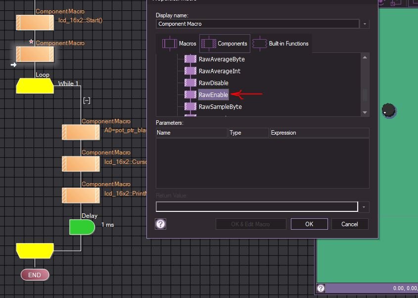

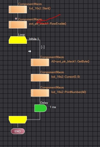

Try to use the help file(wiki) when using components for the AD component you need to enable the ADC on the chip before using it see screen print below
Try it and let us know how you get along

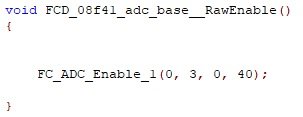

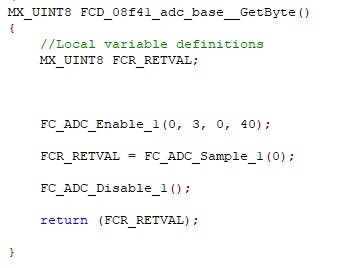

This shouldn't be the case. The Raw enable should already be being called as part of the GetByte routine.
This the code for the GetByte function.
And the RawEnable for comparison.
Niedian, you say solved can you say what did you do to solve the issue? Was it as Peter described?

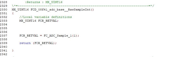

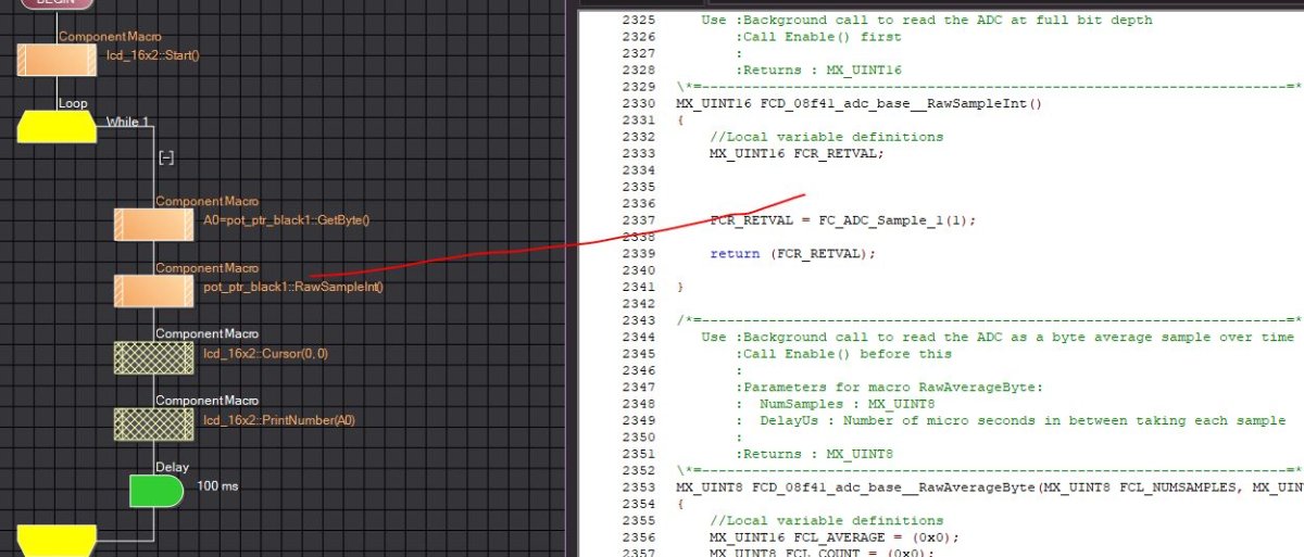

by p.erasmus
Hi Ben,
Ok I see with the getbyte the ADC gets enabled however in my code I use RawSampleInt and AverageSamples and in the C code functions the ADC is not enabled and I asumed it was the case for getByte as well Sorry I mislead the person with my comments however I was sure I had to use RawEnable

by BenR
Hello Peter,
Aha yes for the RawSample you need to enable first :) ok that explains things and glad to know it's not a problem.
