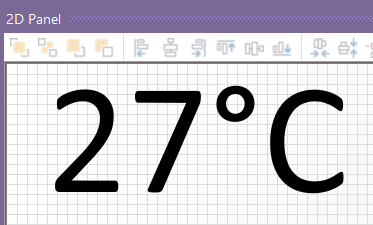

WingNut wrote:
Sun Feb 19, 2023 2:37 pm
The ° symbol has also disappeared
Can you be more specific? It seems to be there for me:
degrees symbol.png (19.01 KiB) Viewed 5763 times
Is there a specific component that shows the problem? Or if it is not a simulation issue, please give more details about hardware.
