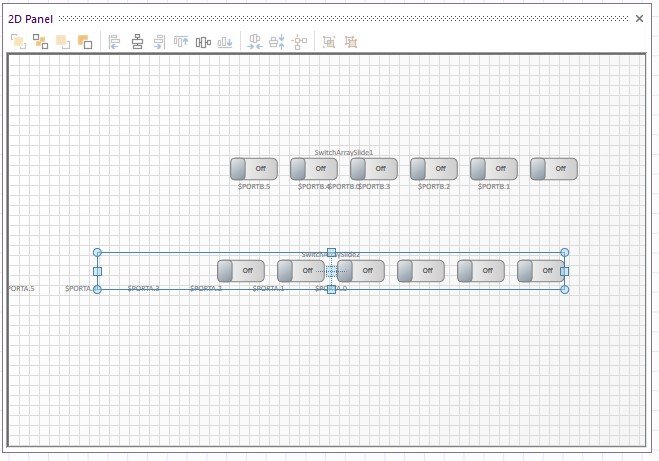

When using the Switch Array (Slide) 2D, when resizing to say 6-positions, the text screws up a bit
Switch Arrays.JPG (52.27 KiB) Viewed 3145 times

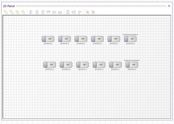

Following on from above, I was using latest FC on W8.1
I tried on my W10 machine running 10.0.0.14 and things were fine
Array Slide 2D FC10-0-0-14.jpg (77.13 KiB) Viewed 3122 times

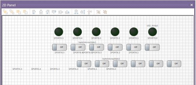

I then updated the W10 to latest (inc libraries) and the problem returned.
Array Slide 2D FC10.0.1.18.jpg (76.59 KiB) Viewed 3122 times
EDIT...
As per advice another post earlier in the week, I deleted my FC10 folder on my W8.1 forcing FC to download latest, problem persists

Further to above, once closed and reopened I can't select the array unless I click outside the switch area and "drag" a rectangle across to capture.
