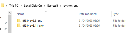

Just a small problem with the toolchain IDF v5.0. It works now , but maybe you know a tip for it.
I have installed FC10 on a new computer with Win10.
Then I downloaded from the internet and instaled:
IDF v5.0.1
Python 3.11
Git
and set in FC10 under: global setting/option/locations the path for ESP-IDF
This give a problem, it did not found the py3.11 folder while compiling
I can not fix i,t so i copy the folder idf5.0_py3.8_env and renamed the copy to idf5.0_py3.11_env.
So it's working and compiling and flush the program to the ESP32 hardware.
Not the best way.....
