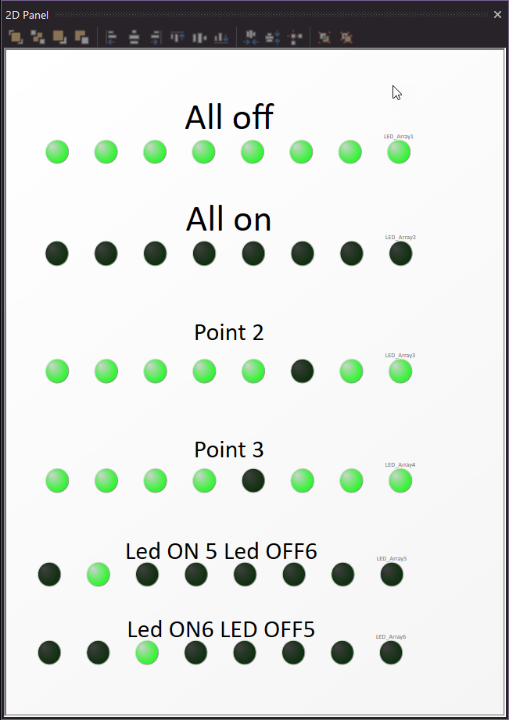

on and off are somehow interchanged and also to set a led on/off is not correct.

Demo for a record button with additional display whether recording is already in progress or has started or cannot be started

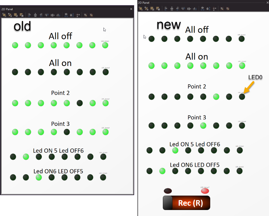

Can you try with the attached component, please?

i have copied the component to
C:\Program Files (x86)\Flowcode v10\DefaultData\FlowcodeV10\Components
and it replaced the old one.
Started FC again, but no change in the component or function

Hi Stefan.
That is the wrong location.
The components are copied from that location to the location below only when Flowcode is first installed
Browse to this location using file explorer, it's hidden by default so just paste the link into your address bar.
C:\ProgramData\MatrixTSL\FlowcodeV10\Components
save the attached component from the post above in the above location
If Flowcode is already open, then you will need to reload your project for the new components to work.

Hi Martin
Perfect! Yes it's working nice.
Also test the Bargraph and WriteValue, and this works nice.
ols vs new

by medelec35
That's great!.
Thank you for the update.
I'm glad your project is now working as expected.
I have requested the updated component to be pushed on the update system ASAP.
