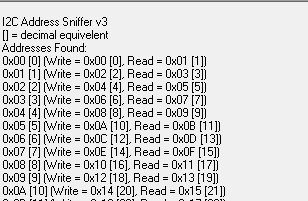

I could very well be doing something stupid, but as sometimes you can't see the woods for the trees I'm hoping someone else can.
I'm attempting to get an I2C sensor running with a Pico. Wouldn't do much so I used the I2C sniffer which returned the following (excert, it runs up to 254 then repeats). I modified the sniffer to use the Pico with appropriate pins
Screenshot 2023-08-20 091054.jpg (26.15 KiB) Viewed 6478 times
Seems strange to say the least. I get the same results with nothing connected to the pins.
Swapping the sensor for a Display on the same pins, I can get the display to work, but if I use the sniffer I get the same as above.
IC2_Address_Sniffer_v3_Pico.fcfx
(22.15 KiB) Downloaded 607 times
EDIT
I did manage to get the sensor to work, but not having much luck with the sniffer on the Pico or on an ESP32-Lolin

Re: I2C & Sniffer
Posted: Tue Aug 22, 2023 8:11 am
by medelec35
The reason is for PICO, ESP32, St Arm & RPI, I2C requires to use transactions.
I will look at this today.
Re: I2C & Sniffer
Posted: Tue Aug 22, 2023 11:44 am
by medelec35
Hi.
I have attached a new version that should work on PICO.
There are caveats.
1. You must have at least 1 I2C component connected or you will see every address appear.
If that is the case you will know there is a faulty component or connection.
2. Will only work in software mode.
I have spotted an issue with the I2C cal file so you will need the attached file for the Scanner/Sniffer to compile.
Browse to this location using file explorer, it's hidden by default so just paste the link into your address bar.
C:\ProgramData\MatrixTSL\FlowcodeV10\CAL\PICO\
save the attached CAL file in the above location.
Hopefully, it will work for you

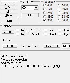

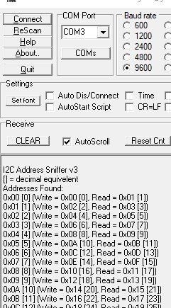

Sorry for the tardy reply, I was called away for a few days.
Just downloaded and tested.
Pico with I2C Display connected:-
Screenshot 2023-08-24 105756.jpg (27.12 KiB) Viewed 6385 times
Pico with display Data line disconnected:-
Screenshot 2023-08-24 105851.jpg (46.53 KiB) Viewed 6385 times
Looks like it's now working fine as you describe :)
Thanks.
