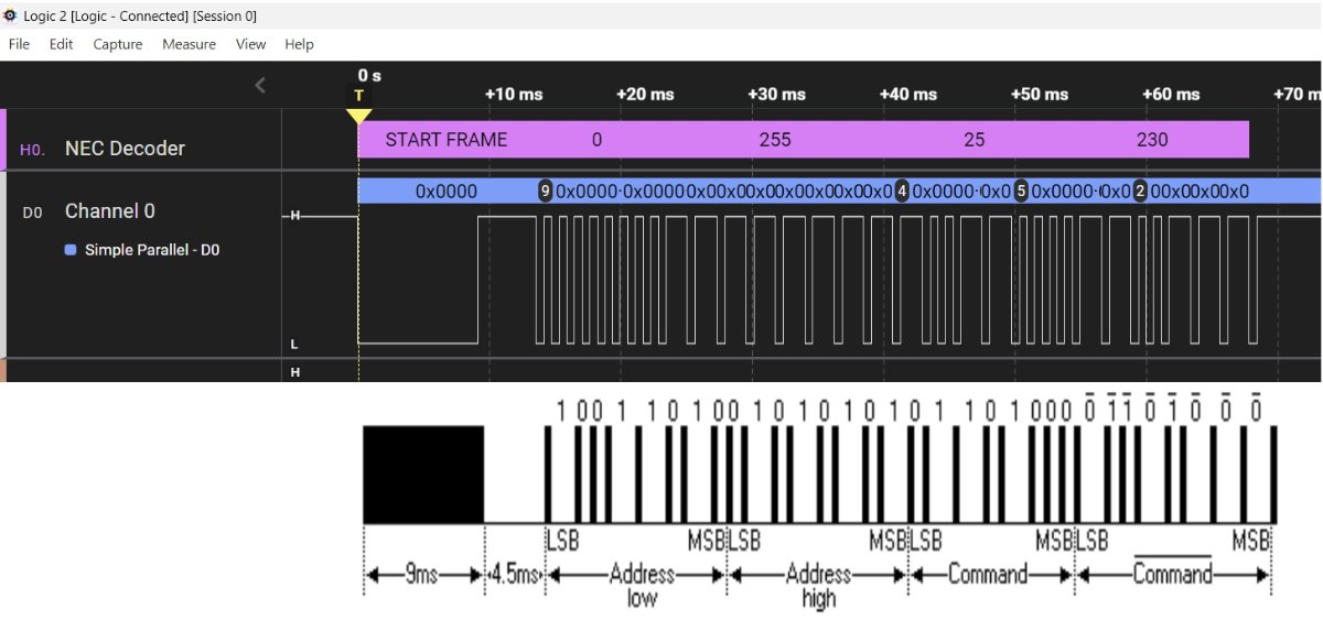

Strange that there isn't a NEC IR component already..
I saw some posts regarding the NEC protocol, but this doesn't seem to be a hard thing to add to FC as a component?
This is a capture of what my logic analyser detects from a cheap Chinese IR remote control.
NEC protocol.jpg (110.17 KiB) Viewed 8425 times
The protocol starts with a 9ms "0", followed by a 4.5ms "1". After that there is the low and high address byte, followed by the data, and the inverse data..

I did a bit of experimenting with this - didn't make it into a component though...
Try
NEC PIC2.fcfx
(23.33 KiB) Downloaded 809 times

It would be nice as a component - the Arduino code above should convert fairly easily - but there is quite a lot of work to do (especially if you want to support different MCUs)
I'm very busy at present but if I get some spare time - which MCU are you using?
