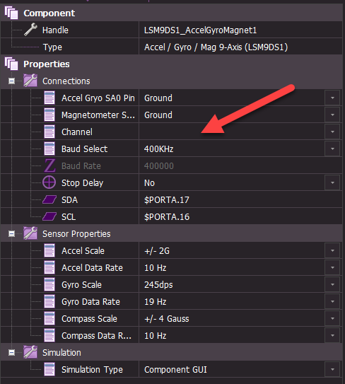

With the LSM9DS1 component i can not compile,
and there is a problem if i load the program again, the I2C channel is not longer select
Maybe some problem with the channel?

The channel issue requires more looking into, but I have attached the updated component, so you can carry on with your project.

For the channel issue can you try the attached, please.
Re: ESP32 and LSM9DS1 not compiling
Posted: Fri Oct 13, 2023 9:53 am
by medelec35
Does not look like the channel issue has worked, so back to the original statement
It was worth a try.

The channel select is simply for me to work with it for a while.
Just select channel1 when loading the program.

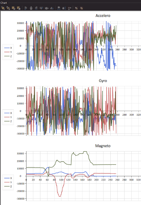

The LSM9DS1 is working.
From the magnetometer the data looks good.
But the data from Acceloro and Gyro dont look correct.
as if the result is not on the correct place in the 16Bit signet integer and then the +- bit is wrong....
I have also noticed this with the component BMM150. There I read the register and set the two 8bit together to a 16 bit signet integer, then the data was correct.
only a small hint...you have to pay attention to ... to change (swap) the IF for using it instead of MPU6886
Do you already have an idea for a solution for setting the channel every time?
