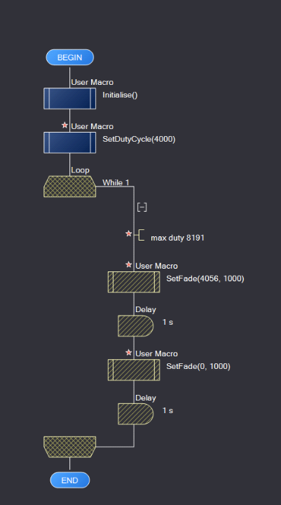

*edit I tried the SetDutyCycle() I used 4000 and it didn't work.

Strange - I can do a SetDutyCycle and output looks good on the 'scope.
One thing to watch - some values aren't allowed and the esp32 will just spit out an error and restart. Open the com port using putty or similar and check if any output (probably a flashing LED on the board is a good sign something is amiss)
Can you post your test code?

I just used your demo and disabled the loop, enabled SetDutyCycle(4000) and ran it. I was assuming this would just set a pwm ~50% at the set 5k rate based on what was in the (). Maybe I screwed up (likely). Remember that I am a noob. All I have done with flow code so far is debug components and chips, and spent money. :) Almost 4 years now.
The ramp up down loop works fine.

If the esp32 falls off the end of a program it will constantly reset with WDT timeouts.
If you add a loop with a delay in (say 500ms) after the SetDutyCycle - then output should stay at the set level.
Re: LEDC PWM Driver on esp32
Posted: Wed Nov 15, 2023 6:46 pm
by Chadb
Ah ok. I'l give that a shot. I didn't realize that you had to have a null loop in there.
I also noticed that you can do basically the same thing if you just set the fade time to 0.
So it works if I put it into a loop but it doesn't work outside of the loop after the initalize.
Posted: Wed Nov 15, 2023 6:49 pm
by Chadb
The set fade will work outside a loop.
Posted: Wed Nov 15, 2023 6:53 pm
by mnfisher
You shouldn't need the SetDutyCycle inside the loop - unless you want to change the duty
4000 isn't quite 50% (~48%) - the duty cycle is a measure of the percentage 'on' time (duty/8192 * 100) - frequency is in Hz and gives the speed of the wave - if you set a low frequency, say 1Hz - then at 50% duty the LED would be on for 500ms / off for 500ms - assuming the hardware supports this - I tested this and - 4096 gives a pretty good approximation of this :-) Obviously to drive an LED you'd use a much faster frequency - unless you want a blinkie....
