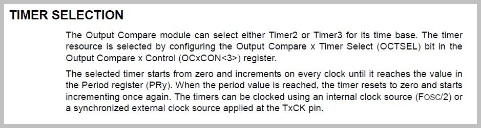

Yes the device has more than 2 Timers however for the output Compare module of the dsPIC33 and PIC24 Family you can only select Timer 2 or 3 as the time base ,This with 2 timers and 4 PWM's you can have 2 different frequencies as the Family only allow for 2 timers to be connected to the OCxCON register. This is my understanding of the Manual, See the reference manual 7000515A
Hope this helps

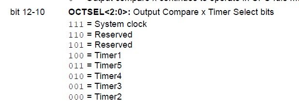

Thanks. The PIC24 family "GB" allows me to select 5 timers. I run the simulator, and have independent control over the pwm values.
Do I miss something?

Yes that is correct as you will see from the Datasheet you can select 5 timers one for each output Compare module therefore 5 different frequency PWM signal this is Possible on the GB family not the GA family
