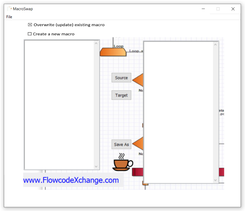

It works perfect! Please more like this.
I think about to use it for update some of my macros.
What about a to choose overwrite or new macro.
Please have a look in the pictures

My thought on this was a dialog with overwrite / rename (user / auto) or cancel..
Indeed it was when I added the check to see if the macro existed in the target FC that I made the mistake :-( I'd pulled it and thought I'd upload to see if anyone thought it was useful...
But - I'm open to suggestions. Auto overwrite/rename??
