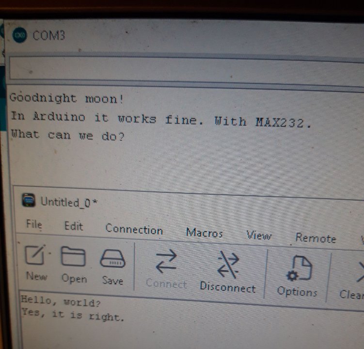

By the way. In Arduino it works fine. Can any explain, why?

It looks like you have used an Arduino sketch found here https://docs.arduino.cc/tutorials/commu ... alExample/ and near the beginning of the code example it warns that not all pins of the intended chip can be used as not all pins support interrupt on change (IOC)
"Note:
Not all pins on the Mega and Mega 2560 support change interrupts"
So you see even your Arduino sketch is using interrupts to receive data, whereas you are not and are relying on luck that there will be data to receive at the exact time you look.
