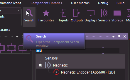

It is already in FC10 libraries:
Make sure you have all the latest components by using the Library update.
Change Files in-use to Full database.
Then select the Components ribbon, and then the magnifying glass.
Enter as5
It has not been added to FC9 libraries.

Hello Dear Martin, thank you very much for your reply.
I found the error. Because I installed the program for the first time, it doesn't install the component until I tell it to do a full update. When I told it to do a full update, it installed the component.
Thank you very much
