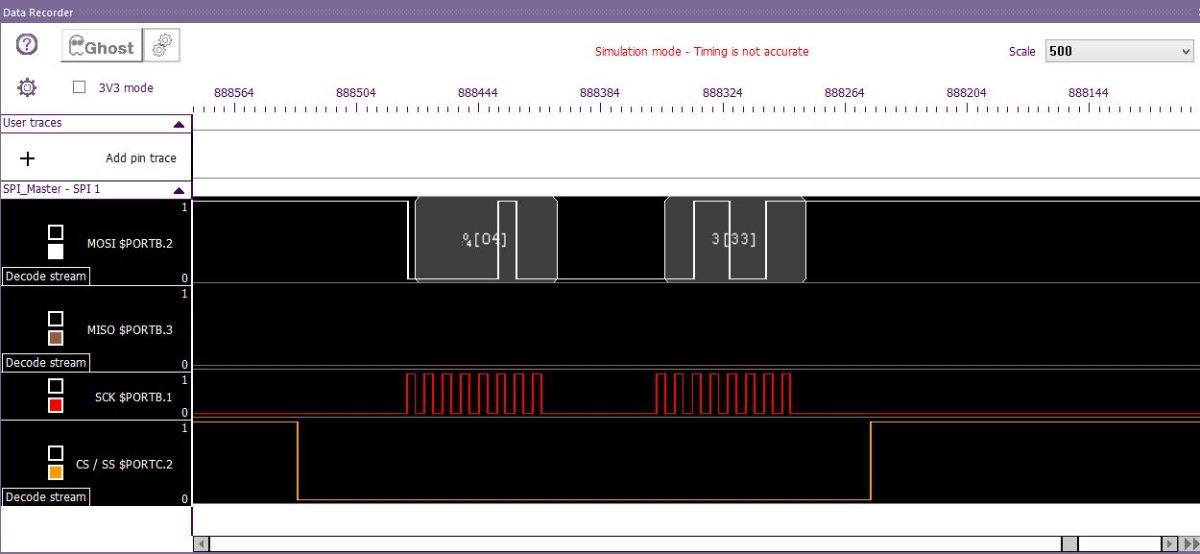

Below is a capture when simulating
Hope this is what you are after.
