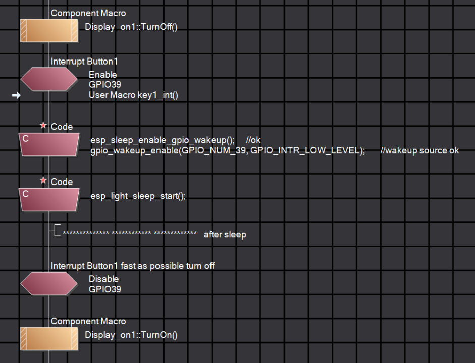

To let a ESP32 sleep i found some c-code and it's working fine
I use a button on gpio39 to wake up
Democode here:

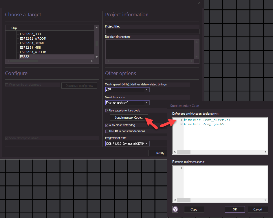

just add this:

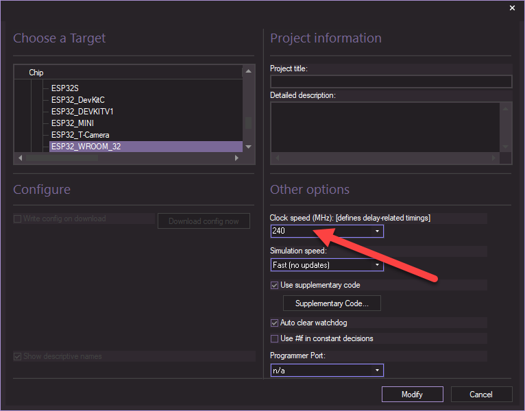

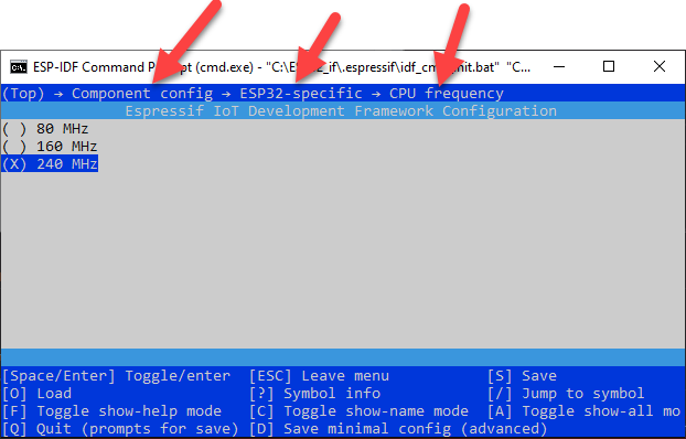

I found a way to change the clock from the ESP32.
in the menu,
component config -> ESP32-specific -> CPU frequency set to 80Mhz
and in Flowcode in the project option set to 80Mhz.
This way I can save 20mA current and for my project it's still fast enough.

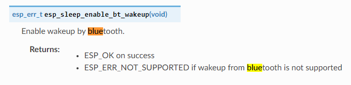

Hi Martin
I found this site and already tried, but always i get a fail.
but sleeping and waking up with pin is working.
Am I doing something wrong in the C code?
Command in FC:
Command in PDF:
Re: ESP32 power Power Management and sleep
Posted: Mon Mar 04, 2024 1:35 pm
by stefan.erni
I can found if i look in V5.0.6 commands, but if i look in V4.4.7 there is no command for wakeup with BT
It's it looks like it only works from version 5 but then with version 5 Bluetooth does not work with Flowcode
