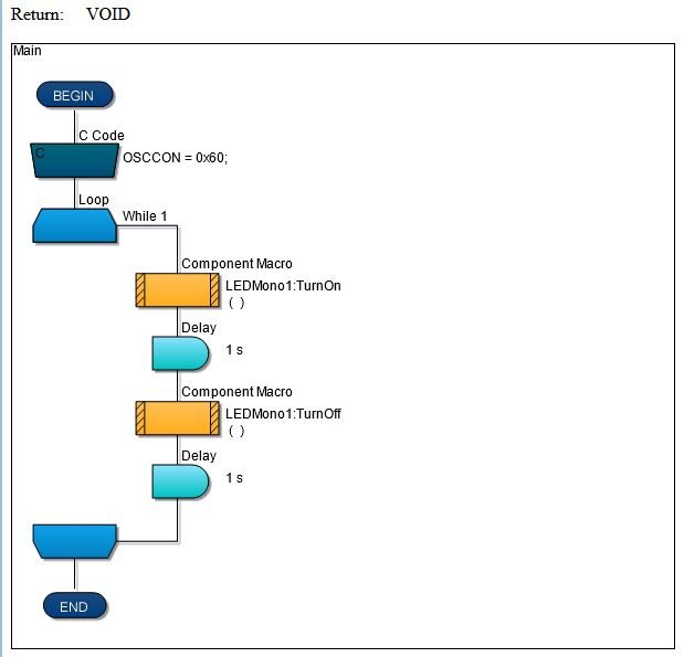

Use the Browse button to navigate /select your usual flowcode file (.fcfx) and Upload button to view it.
It's a tool Ben kindly created and shared independent to Flowcode / Matrix TSL that displays your Flowcharts / variables etc.
Below is an extract from the viewer and the target file used.
Flash_25K50.fcfx
(10.23 KiB) Downloaded 1047 times

I've used it a few times when presenting to those unfamiliar with technicalities as it's easier to "explain" without the rest of the Flowcode icons present.
